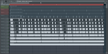

So, first I compared realtime versus outputted ticks with a minisynth output to mono l&r. It was close enough that I decided it was worth tweaking. So, I kept multiplying each signal by 2 over and over until the output was consistent. I like the effect; It's very earthy.
And here's How I achieved that with a ruby tick and a bunch of playing with scaling.
It's certainly not perfect, but that was the whole point. I'll add another switch so that realtime and vintage mode can be selected. My father used to work with electronics. All in all I can tell You; Even if the capacitors and resistors which were used to run governors; They'd still only be at this level of efficiency. The only contradiction had been of course clockwork that was made with refined metals.
Because the oxide was wrought from the steel; Its movement was reliable and measurable, but capacitors and resistors of the day were still made with imperfect materials. Now they use carbon I believe which can be standardized.

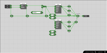

Here's the latest schematic with that functioning and I'll get the realtime version up and going probably by tomorrow.
edit: OK, last updated version was too fast. And too many nyquists is too much of a good thing, OMG. I think realtime might actually hurt the ears due to exponential amplitude and average.
Glad nobody downloaded it, lol. This new version has 40 ms of de-zippers to counter-act the effect. Realtime? Be careful what You wish for. Have a listen in realtime and that's about 800-900 ticks per second; Just imagine if it was realtime.

So, I also did My homework; Looked at this schema and figured what it does and does'nt do. And I made this video which clearly shows that it would have always made a linear [0-1] nyquist wave, lest You set the averager way down.
I documented this very well in a Youtube vid:
So, I'm glad How it turned out though, I'm not insulted and this led to innovation, because obviously the timing was off. And while the solution I came up with is not as technical as it could be; It sounds great. And I like that. I felt it would have been a strange and hard trick to create an asm linear to db and db averager which ultimately was timed like an envelope. I guess the challenge I had realized was; Ultimately it always meant there would be latency enforced. When in fact I just wanted a bit of latency.
Take a look at the LA smooth modules I came up with and You'll get the idea. It's actually a really fast slide that works well just using dezips. Pretty neat.
