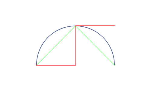

So you don't want a sample and hold? I'm not quite sure what you mean by this:
tulamide wrote: My goal is to simplify the waveform through linear interpolation, but keep the overall shape similar as long as possible
Can you explain a bit more what you want to achieve?

Correct, I don't want sample and hold.
I hope it is ok that I make a visual explanation. For me that's the easiest way to describe it. In the image, the assumed original waveform is drawn in blue, red would be the result of sample and hold, while green is linear interpolated and what I'm trying to achieve.
However, it really was just an example to the topic of how to deal with tasks that require a buffer, introduce latency, etc.
