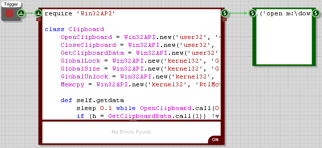

Posted: Thu Nov 13, 2014 3:30 pm
by JB_AU
Paste from clipboard

Hi JB,
Why isn't this working in my compiled EXE (v3.06/3.07) ???
I also added optional a WIN32OLE modul for a WMIC cmd... this even crashes the App/Exe... :(
Please HELP!

What are you trying to do exactly, paste text, bmp, audio ?
I possibly need a refresher!
I wrote this in 3.0.5 & haven't used it since.
Re: Paste from clipboard
Posted: Fri Feb 13, 2015 11:26 am
by JB_AU
Paste.fsm
(659 Bytes) Downloaded 1260 times
I think this is from 3.0.5 and works when compiled in that version, what changed in 6 & 7 ? & Why???
"/C WMIC /Output:CLIPBOARD logicaldisk where "drivetype=3" get deviceid, volumename /FORMAT:CSV"
I just wanted to avoid the temp file creation and loading...
it works already with piping into file (as usual) in the Roaming folder but... not the fastest/secure way...
