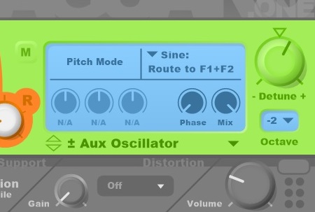

I highly suspect Tepeix version works well inside my LFO, because there I only need the Split Exp functionality... and MV's version for the Aux Oscillator.

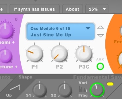

This will be a DAMN NICE update (subjective for me atleast as newbie :lol: ) when I eventually finish it, since it adds some more possibilities for variation...
Knobs already in place from previous version... ;) for the knobs needed for your ASM:ed Split Exp and Mix-in Odds modules.
Slice and Frag modulatable, now with Vari modes. Either retains/adds some sizzle at high reso or makes a trash:ier sound... Fit perfects for the plugin since it's a techno synth.

Moreover, the math in MV's version had a bonus up it's sleeve... that made it a "two for one".
Seems i'll get yet another oscillator style from the same modules. Interesting! :P
