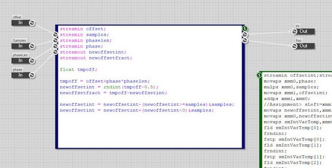

martinvicanek wrote:Here is my 2ct:
I totally agree with Spogg's comments regarding the precise counter. We could safely replace it by a simple counter for the present application.
I also agree with Tepeix' phase code v2. I am attaching my own version with comments (primarily for my own benefit, because otherwise I won't know what the heck all that is about by next week). It is almost identical to Tepeix' code.
So the remaining mystery are those FM spikes and double triggers that k brown is observing. Could we have the schem to see what`s going on?
In the assembly with the int and frac out it says at the end:
movaps j,xmm3;
movaps jfrac,xmm3;
but should be:
movaps j,xmm0;
movaps jfrac,xmm3;

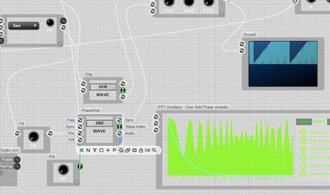

Well, in my own, stumbling, hunch-following, trial-and-error way, I seem to have figured this out.
Just putting this 'Add Phase' code from the iFFT osc between the original Razorblade osc 'Counter' and 'Interpolated Read' modules did the trick. Just needed to give the 'phaseLen' input a float of 168.562 (as in the iFFT), to set the Buffer Size, then the 'phase' input functions as expected.
Add Phase code.jpg (44.34 KiB) Viewed 487348 times
A few minor wrinkles remain:
1. One-shots still double-trig (no biggy in a project to bypass the 'AddPhase' module for those waves).
2. The float range is strange to achive squ thru narrow pulse: 1.561 to 0.265.
3. Not sure the HiQ option is working, as the 'Add Phase' doesn't have both 'PosInt' and 'PosFrac' inputs; only 'offest'.

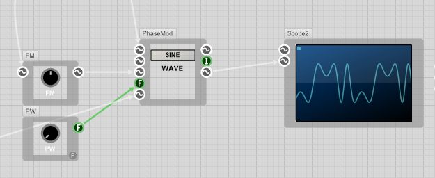

FM with two sines at Ratio 1:00 looks and sounds just as expected:
Propa FM.jpg (23.87 KiB) Viewed 487348 times
PW/PWM still work just fine, as does Sync!
I might be missing something, but so far everything seems to work fine.
