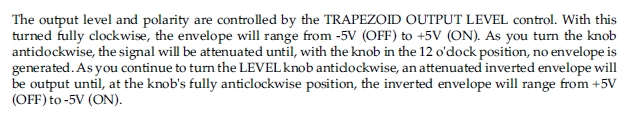

Wow - I am green with envy of your green-blooded prowess with envelopes - first the Voyetra's odd-ball and now this :D :mrgreen:. As far as I can tell everything checks out; I only had to change the Trapezoid output to be bi-polar:
Trap BiPol.jpg (64.12 KiB) Viewed 25859 times
I also made the env switchable linear or quasi-expo; the manual for the VCS3 and the one for the modular copy doesn't say which it was - I've always assumed most vintage EGs were expo due to the nature of the analog circuitry.

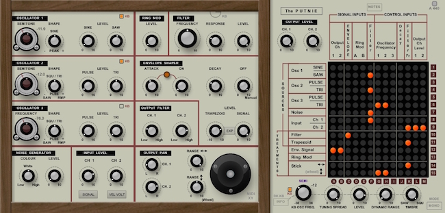

The ol' PUT' is now officially v1.03. Also went through the manual and got most of the signal ranges pretty close to right; this odd-ball had different output levels for each waveform. The joystick CV range was 0.6666 of the Trapezoid, etc. Because of the graphics in the VCS3 manual I'd always assumed the Tri > Saw/Ramp control was a smooth 'morph' of the shape, but the old synthesis book by Alan Strange (and he would know) clearly shows the VCS3/Synthi Tri shape control being a simple cross-fade, like the Moog Voyager; so with the uneven output voltages, the Tri output goes from a half-level Tri to a full-level Saw (or Ramp) -weird! I also got the Osc freq controls looking a bit more like vintage verniers - why not? :) :geek: I'd also neglected to make the Input amps inverting, so they can be used to invert CVs.

UPDATED 6/19 - minor GUI tweaks; no change to 'engine'.

I think it's Your best looking skin. But I might add some rounded rectangles that are baby blue behind one letter or something to bring the logo somewhat. Like behind the firs letter or some, baby blue I think would be best or even frosty blue as it would create a really interesting effect.

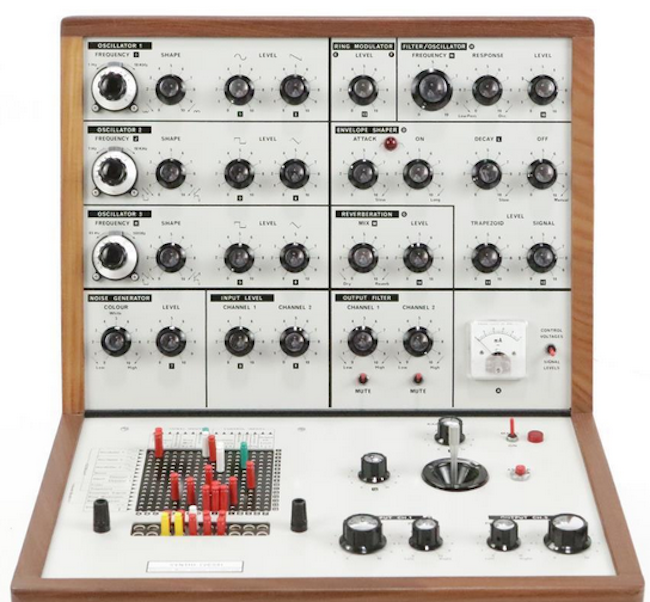

The design is not mine - it's trying to look as much as possible like the actual synth - the EMS VCS3, nicknamed "The Putney".
This particular specimen is missing the silver caps on the knobs (or they are black on this one - hard to tell).
