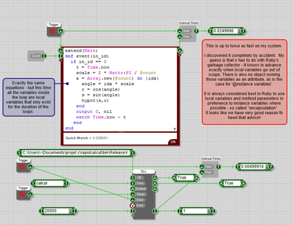

hi guy's ,
I test your benchmark trog well and thank you for this nice work :)
I wanted to test how quickly a dll following (and respecting your code of course)
see how time put with a dll.
and the result is interesting outright I see attached below the fsm and the project dll to prove my good faith: p
a screen capture on my pc to the result obtained
and now the project file and the fsm
rapidcalcul.zip
(49.76 KiB) Downloaded 1031 times
C + + is faster is normal this is not an interpreted language but I will think that to load a dll in memory have done it but not waste time :)
Re: Red vs. Green - vs. the Developer!
Posted: Mon Dec 16, 2013 2:14 pm
by Nubeat7
wow its about 5 times faster here on my computer, thank you very much for providing this example!
Posted: Mon Dec 16, 2013 4:09 pm
by trogluddite
Wow! - thanks a lot, Mmix, that is a excellent demonstration - the perfect completion of the benchmark comparison.
