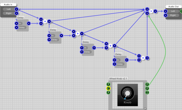

This would have been correct... I think.
Feedback 3.PNG (45.71 KiB) Viewed 19573 times

If you want to make an echo delay,
loop the output of the delay back to the in,
punch 11025 samples delay, and put a knob that goes up to .9
in the link that feeds back from the output to in.
ATM- u r not creating feedback.
Delays do not have feedback built in, u have to route it.
Cheers :)

nix wrote:If you want to make an echo delay...
No actually, I know how to do that. I was just testing the theory that feedback loops are delayed by 1 sample per cycle (and that this was the nature of the high-freq attenuation) by recreating the effect to some degree using delay modules. I guess at this point I'm just confusing people. :P

The original model had feedback topology (delayed output goes to input), this uses feedforward topology (delayed input into input), they are totally different. Feedback is one-pole filter whether feedforward is all-zero filter, which basically FIR filter (or a very simple convolver). It is however often used in oversampling as a lower quality CPU-friendly alternative (I think is also in the oversampling toolkit).
one pole filter has an impulse response of exponential decay. If you what to recreate it using delay modules each delay has to be x % quieter than previous. like 1, 0.5 , 0.25 , 0.125 , 0.0625,...

From a more "musical" point of view, the "multi-feedback delay" schematic is a phaser or flanger effect - but without the LFO that normally makes them "swoosh" around the frequency spectrum.
The bizarre frequency changes that KG alludes to are what give those effects their signature "psychedelic" sound. Very useful to make a sound more "synthetic" sounding and draw some attention - but not so good for unobtrusively EQ'ing your lead vocals to sit in the mix!

trogluddite wrote:From a more "musical" point of view, the "multi-feedback delay" schematic is a phaser or flanger effect - but without the LFO that normally makes them "swoosh" around the frequency spectrum.
Right, of course. Which is why I was initially baffled by the "single pole lowpass" and the drawn out mathematical explanation. To my more simplistic musical understanding, combining a delayed signal with the original yields phase cancellation, and feedback enhances that effect (though I realize as well that it will eventually lead to resonant sounds, which I can understand that webpage was endeavoring to explain mathematically). It just seemed needlessly complicated to me. :P
