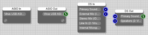

nix wrote:The thing is, we all have different audio setups - and your default setting will not be correct for us anyway.
Wow ! Does it mean that if the user has another ASIO-capable card installed than mine, that the demo .fsm could be useless or harmful for him ? I'm curious to see how the Audio Menu appears on different machines, once you enable Audio (new .fsm uploaded in post #5 above).

Here are the dialogs on my internet machine.
My other system has 3 ASIO soundcards installed,
so the selection would be randomly one of those.
Yes, leaving audio on can cause problems for sure.
It will just turn on a random configuration.

steph_tsf wrote:Wow ! Does it mean that if the user has another ASIO-capable card installed than mine, that the demo .fsm could be useless or harmful for him ?
10 people 10 answers. In my case yes and yes.
But thanks for updating your work. Much safer and maybe the way to go for future releases from you.
