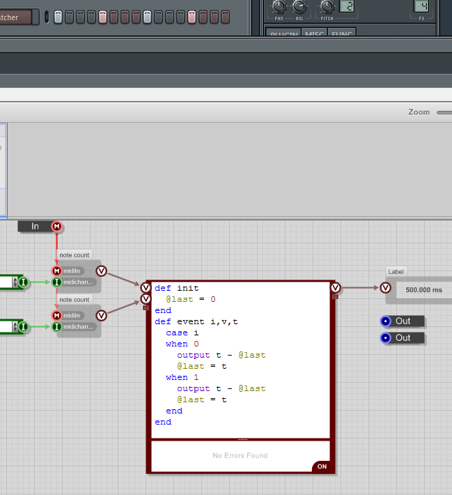

But that test would be futile, since has nothing to do with MIDI mgmt inside FlowStone :shock:
The problem is dealing with MIDI...

it doesn't matter because it proofs if the plugin itself introduces any delay if it doesn't also any outgoing midimessages will be tight, beside that it tests the input of a midi sequence
you also could modify the schematic to test 2 incoming midi notes one on channel 1 and the other on channel 2, i just don't know if you could do the routing for this test in FL, one channel would have your FS vst in the chain and the other not... just an idea like ive said before i have no chance to test atm

With the script you've posted, the Label output 500.000 ms. Always, FL being stopped or playing...
Not sure at all if I'm doing the right test:
