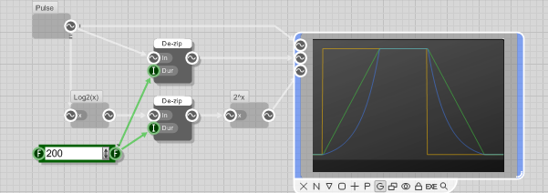

by martinvicanek
zucker1 wrote:I need a way to prevent These "large" step at the beginning of the transition.
Is there a way to Change the behaviour of the dezipper or a "code-Version" of an dezipper that i could modify???
The dezipper will respond to a sudden change by linear ramping from the last value to the new value. If you have only positive values (=delay times) to consider and you want slower ramping for low values and faster ramping for high values, you could sandwitch the deziooer by a nonlinear function and its inverse, respectively.The screen shot below illustrates the idea fora log/exponential pair (both base 2):
yellow - input step function
green - plain dezipper
blue - sandwiched dezipper
If you are concerned about CPU load you can do two things:
1. use my optimized stream functions at Flowstone Guru
2. depending on your ASM skills - skip code if value does not change. KG's blog post at FS Guru tells you how to do that.

by adamszabo
would you be able to post that schematic Martin? :)
