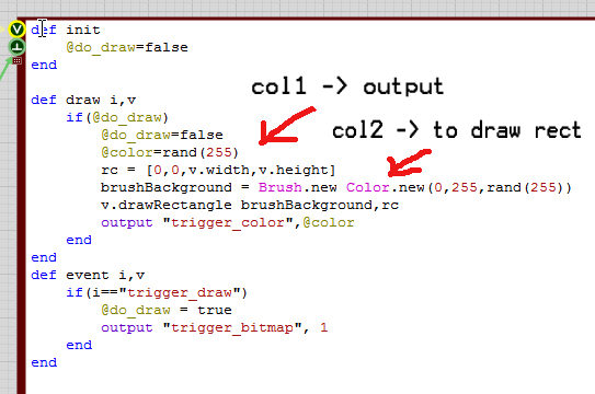

Nowhk wrote: When you trigger, the color in the "current background" must be the same of the one in the generated "Bitmap", but that's not always true (or maybe: its rare that the two are the same).
sure, when you are using 2 different random colors, they will not be the same...
They are not 2 different colors :) I choose one (random), I draw the V and I send the color as output (to monitor it). The color is one.
What I'm looking for is exactly the project posted above (except that I dont draw only a background, but 45000 points, which is expensive). Draw once, export as bitmap (what I just draw, no different things) and just stop to draw again (using the flag). Even if I store the array with points (without calcolate them every time), to draw that amount of points (at Tick100) freeze the application.
I'm programming since 18 years right now :) But 4 days for creare a bitmap is huge I guess. In C# it tooks 3 lines of code and five minutes to get it. Thats what I meant as hard task in FlowStone :D

Nowhk wrote: They are not 2 different colors :) I choose one (random), I draw the V and I send the color as output (to monitor it). The color is one.
2 colors!
still don't understand what you exactly want to achieve, if you want that other people fix your problems you will need to share them...
