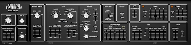

Before I'm off for a week's vacation - here's a new one, not in the Bundle. But this baby arrives in the world automation-ready: Rolend SH-12. A mash-up of the SH-1 and SH-2. This is the 2-osc synth Roland should have released after the SH-1. All the features of the SH-1, but with the second osc and it's associated features. Why they released such a crippled synth as the SH-2 is beyond me.
https://www.dropbox.com/sh/5w1fp5n3k9hu ... WimGa?dl=0
Rolend SH-12.jpg (83.56 KiB) Viewed 35590 times

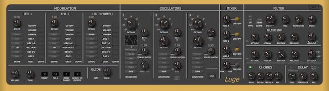

~StudioLogic Sledge:
Luge copy.JPG (32.49 KiB) Viewed 35490 times

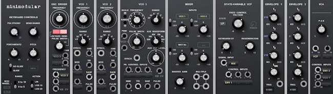

An approximation of the minimoog architecture with modular components:
minimodular copy.jpg (128.48 KiB) Viewed 35490 times

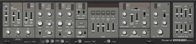

Mash-up of ~Roland SH-5 and SH-7 in SH-5 livery:
Rolend SH-57 copy.jpg (82.38 KiB) Viewed 35490 times
