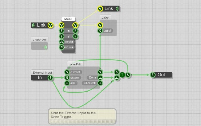

hmmm ... we have a problem Houston :(
OK ... editing data within the box is working. BUT
The Input to the front end of the Edit Box ... for Data coming in from Disk is not ! :o
The 'internal' value is not being replaced with the Disk data [coming in from an Array].
I'll post up a schematic ASAP.
note: pushing a value into the front end will change the Edit Box display ... but the edit box is not outputing
that value.
I'm wondering if this is why TROG had some coding going on outside the EDIT BOX [as I have shown in the 1st message pix in this thread] ... off to test.

by Nubeat7
RJHollins wrote:hmmm ... we have a problem Houston :(
that value.
oh, yes, because there is the sample and hold prim in between there must be sent a trigger when extern data comes in, just connect the extern input also with the done trigger!
Re: INPUT Box [now to use RUBY]
Posted: Tue May 14, 2013 12:47 am
by RJHollins
:oops:
If I could follow your instructions ... I would certainly try to do that :shock:
But I have MUSH for Brains :roll:
OK ... did I understand correctly ?
