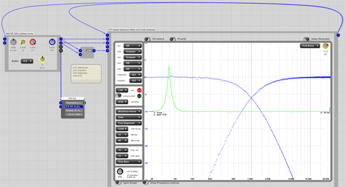

People may not like the double 2nd-order Butterworth lowpass filter.
People may prefer a lowpass filter guaranteeing no preshoot and no ringing.
bidir IIR LR xover (500).png (68.65 KiB) Viewed 41060 times
How to implement a 4th-order Bessel lowpass, using the bidirectional IIR filtering?
Is there an IIR filter implementing the square root of a 4th-order Bessel lowpass?
Square root, because when executed "forward" then "reverse", it should equal a 4th-order Bessel.
Any advice welcome.

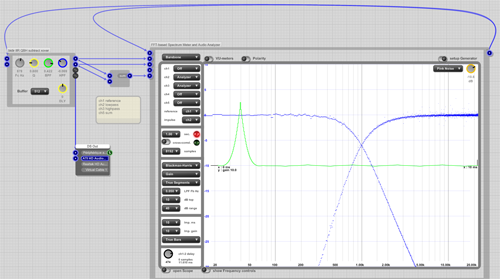

I made Q adjustable.
Almost no preshoot and ringing when Q set to 0.600
Real Fc = 1000 Hz when Fc knob set to 1230 Hz
Lowpass slope 4th-order like Linkwitz-Riley.
Highpass slope something like 2.5nd-order.
Looks okay. Makes me happy.

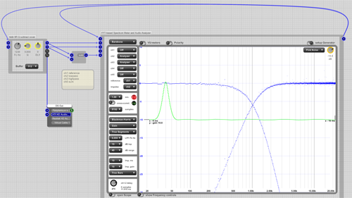

I made Q adjustable, and added knobs for adding a thin amount of bandpass energy and highpass energy in the woofer signal.
Real Fc = 1000 Hz when Fc knob set to 878 Hz
Lowpass slope something like 2.5th-order in the audio band.
Highpass slope something like 3rd-order.
Looks great. Makes me even more happy.

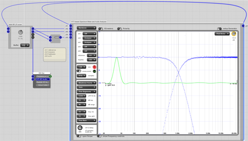

For completeness, here is what's happening when specifying a 1st-order lowpass.
No preshoot and ringing, of course.
Lowpass slope 2nd-order as expected.
Highpass slope 2nd-order as expected.
This could possibly deliver excellent results with quality woofers exhibiting a well controlled high frequency roll-off, and quality tweeters able to handle power down to 1 kHz. Kind of audiophile approach maybe. This is worth trying in first place, especially when applying 128-tap FIR filters for linearizing both drivers, individually.
bidir IIR QLBH subtract xover (500).png (52.9 KiB) Viewed 41051 times
I'd like to experiment this using 32-bit audio on a ARM Cortex-M4 like STM32F4 (168 MHz - two I2S), or preferably a MIPS Microchip PIC32MZ (200 MHz - three I2S). For simplicity, a WM8580 could be hooked as I2S clock master, for featuring the S/PDIF-in and up to 6 channels of analog audio out. Can somebody help ?
