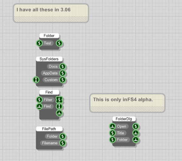

tulamide wrote:Spogg wrote:When you switch to Expansions you load a folder (not wavs). This is only possible in the FS4 alpha.
Gratulation on your system. Sounds like a good approach. However, the quote above is not true. You can do the same thing in 3.0.6 as well.
Well my toolbox was broken, so I fixed it from a backup.
However I still couldn’t find the Folder dialog prim. I also looked in SynthMaker and not there either.
So I’m still of the opinion that it’s new in FS4 (and wait to be shot down!).
- Folder dialog FS4 only cropped .png (130.71 KiB) Viewed 23605 times
The attached schematic is made in
FS4 alpha and contains the prims above.
Re: Help Johan with Rompler expansion system
Posted: Wed Jun 24, 2020 1:54 pm
by tulamide
Spogg wrote:tulamide wrote:Spogg wrote:When you switch to Expansions you load a folder (not wavs). This is only possible in the FS4 alpha.
Oh, I see. Your quote was misleading then. "Doing it in green (without Ruby) is only possible in the alpha", is what I would agree to immediately. It is no big deal to load all files from a folder in Ruby. It is also no big deal to select a folder. You just don't have the system-provided folder dialog, but your own solution.
