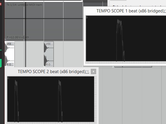

This is all kinds of weird. Did this work perfectly for you ?
Maybe I am just misunderstanding this and it should not start at the beginning of the scope window ?
That would explain a lot?
I hit play and it shows up here .

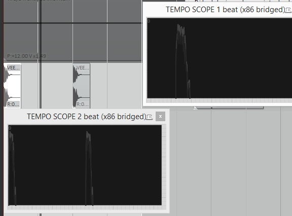

I hit play again and it shows up here.

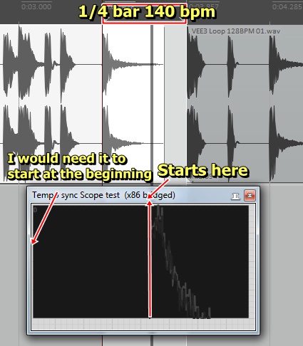

The "problem" for me is getting it to start at the beginning of the scope window.
It is not clear to me if it should do that and just not working or if its designed like this ?

Still trying to get this to work , but using this approach I cannot get the scope to start at the beginning of the scope window. Basically what I want to achieve is when looping say 2 bars in the daw it will show 2 bars of waveform.
So not a scrolling display and one where it starts drawing at the beginning of the window.
