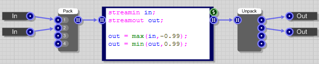

I often see this dreadful stereo clipper module in schematics right before the audio output:
To be sure, it is a good idea to have a clipper there in order to prevent overloading the hardware, which would sound much worse! Of course it is best to stay within the (-1,+1) range in the first place, so the clipper is just a safeguard.
So why do I call it dreadful? Because it is extremely inefficient! Ironically, the design indicates an intention to save CPU by exploiting SIMD for the two min/max operations. However, due to the overhead from the Pack/Unpack modules the savings are more than undone: the dreadful stereo clipper uses 85 cycles on my computer. To put this into perspective, you can build a 4-band parametric EQ with less CPU cost!

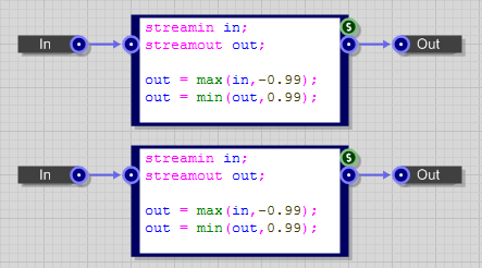

Actually you would be much better off with a naive replication of two clippers (15 cycles):

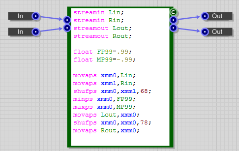

That's not bad, however if you really want to go efficient I'd recommend this optimized stereo clipper (4 cycles):
Here is the code:
streamin Lin;
streamin Rin;
streamout Lout;
streamout Rout;
float FP99=.99;
float MP99=-.99;
movaps xmm0,Lin;
movaps xmm1,Rin;
shufps xmm0,xmm1,68;
minps xmm0,FP99;
maxps xmm0,MP99;
movaps Lout,xmm0;
shufps xmm0,xmm0,78;
movaps Rout,xmm0;
