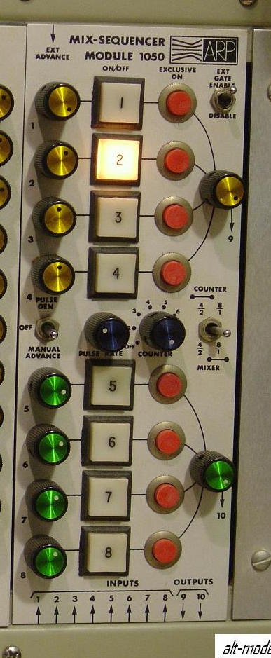

Hi all you Flowstone Gurus out there (in here?); up to now I've tried to avoid asking for help actually building something (well except for hinting that someone pitch in with the Buchla Source of Uncertainty and sequencers), but now I plead for assistance with something that I just can't get to on my own.
I've been pretty happy with the progress I've make with the ARP 2500 emulations, but a couple of the systems I've assembled really are in need of mixers. The only one ARP ever made for 2500 was the 1050 Mix-Sequencer. Building the mixer part was no problem, but the 'sequencer' function has got the best of me. The 1050's sequencer function was not a sequencer in the usual sense - it didn't generate a series of control voltages, but rather switched a series of audio inputs on and off in sequence at up to audio rates. So clearly the answer can't be found in the various SM/FS Step LFO/Trance Gates that have been built. Using stream-to-floats to switch selectors on/off is very clumsy and at rates above a slow clip-clop it has two left feet. I don't know if this can be done with greens somehow or requires writing code, but trying everything I know how to do has gotten me nowhere. Before giving up and just using my Mixer-only version, I thought I'd put up an appeal here.
Description from the 2500 manual:
1050 pg1 copy.jpg (235.04 KiB) Viewed 37867 times
1050 pg2 copy.jpg (178.48 KiB) Viewed 37867 times
Even just the mixer part is a pretty cool unit - it can be two four-input audio-or-CV mixers, or a single eight input mixer with each sub-group of four having it's own master output level. Exclusive-on buttons instantly mute all inputs but that one, each input can be shut off individually without disturbing it's level adjustment, etc.
Also the description of the Counter/Mixer switch is rather obtuse and I've yet to completely grasp it.
Thanks so much.

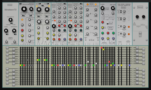

An example of an assemblage of modules that could really use a mixer:
tonus Nineteen70 d_small 640w.jpg (256.5 KiB) Viewed 37867 times
The only mix function here is the four-input mixer in the 'Filtamp' (VCF/VCA); one could use those up pretty fast.

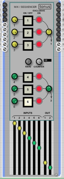

My stumbling attempt:
mixSeq work.osm.zip
(289.48 KiB) Downloaded 1096 times
Only three inputs per mixer, because in my emulation of the switch matrix, only eight switch positions per module fit. The 1050 had eight inputs and two outputs; the 2500 had 10 switches per module slot.
