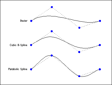

KG_is_back wrote:cubic (currently broken)
I'd be interested in how you plan to implement cubic! I only know it from the graphic area, where it is derived from linear interpolation, like so:
pseudo code
def lerp(a, b, t)
  return (1 - t) * a + t * b
end
def quad(a, b, c, t)
  return lerp(lerp(a, b, t), lerp(b, c, t), t)
end
def cubic(a, b, c, d, t)
  return lerp(quad(a, b, c, t), quad(b, c, d, t), t)
end
As you can see it is way too much code to efficiently work in the DSP code editor, so I'm trying to find a simpler approach.
EDIT: To visualize it, the bezier curve would be the result of above code with the points being a, b, c, d from left to right.
