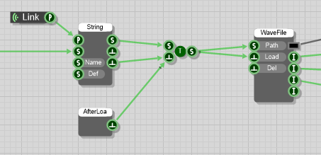

I'm not really sure you can always define the triggers and how they need to be invoked in FlowStone. Look at this:
Preset String load the S from preset after the "After Load" (so when I load the VST, it will never refresh to the new value from preset, but always the one from schematic).
Even if I sync the array of coordinates and channels in Ruby before calculate its coordinates, I need first to hold and sync the loading of "path" from preset. And I'm not really sure I can do it here, since, as I said, there is no timing/sequence/trace of parents here.
Maybe there is path/string from preset, maybe not. And I don't know when this trigger happens and if happen from schematic or from Preset (so decide which is the last one, i.e. the more updated value), and when to trigger it. :roll:

Nowhk wrote: I'm not really sure you can always define the triggers and how they need to be invoked in FlowStone. Look at this:
Why do you use a s&h? The purpose of it is to not ask back to the preset string, but keep its value until the preset string sends a trigger! That's the complete opposite of what you want to achieve.
When you load the schematic, it loads [F]s from mem, than from preset string (or the opposite, as you say is unpredictable). Since triggers are not sequenced, it could (in order) load/trigger part of different mem. Let say mem is linked to Min/max prim (which output 4 array at different timing), Left min array is sent to ruby from the mem of schematic. Then preset string trigger before other arrays come to ruby, and I could have at the same time [F]s from two different mem (the one loaded by schematic and the one generated by WaveFile prim after it got new path from Preset string).
Thats why I thought to s&h: dont load anything till the last (more updated) wavefile need to be processed. I can't see any other way to use the most updated (splitted) arrays all together. But seems I cant since I can't know when Preset string acts. (note: If preset string is empty, the data that need to be processed is just the one from schematic, of course).
Maybe I'm really so stupid to not get this; but after what you say, there could be panic everywhere if triggers works this way (this is a case for example). Or I'm missing some important chapters that I don't see...

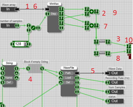

Nubeat7 wrote:here is a good example how it should work fine..
http://flowstone.guru/downloads/sample-looperplayer/
It suffers my same problem. Even if it will works (as for my example) with a ratio of 99,999/100.
For the theory of Triggers (even if I need to read with more accuracy the Spogg pdf suggestion) it could fail.
See this example below. If this happens (I see it is "hard", but it could since Triggers acts asap without any sequence, as you said):
when Ruby reaches both Array (step 3 and 8) and check them with the tulamide code counter method, it will process one array from the wave stored in mem and the other one from wave stored in the preset. This is a ISSUE. Not a possible issue. Its real. And I don't see how to fix it since I've no control on Preset String prim.
I don't want use a single array and a single M2F as I did before: your method is faster, clearer and lighter; since, when I save the schematic it save to it 4 array of 200/300 points, not one of 700.000 (it often freeze the application itself).
