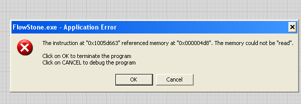

Last few weeks I've had a trojan trying to access the web(keep getting the "hourglass" pointer),
and very often, have been getting similar popups like this.
But today it didn't read "Flowstone"...it read...comsrvr.exe
..no copy in win/sys/32.....it was in app data...
Zone Alarm free picked it up along with 2 more
noopq.exe
dxKKKK.exe
back up and running clean now. stable at the moment.
