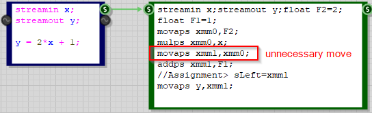

When you inspect the ASM code of a DSP codebox, you will often find unnecessary moves:
This can be a problem for long formulas like evaluationg a higher degree polynomial, where the compiler might run out of xmm registers. Note that you won't get a warning in that case! :mrgreen:

martinvicanek wrote:This can be a problem for long formulas like evaluationg a higher degree polynomial, where the compiler might run out of xmm registers. Note that you won't get a warning in that case!
:D
Good heads-up if I ever get to the point of prototyping more mathier stuff. That overwriting would probably taken me a while to catch... :? or rather would probably have thrown something out the window :lol:
Hmm... so basically I have entire oscillators worth of unnecessary movaps just in all of my synths multi input "range checks" spaghetti (summed together) alone :shock:
I don't know if I should consider this good news or bad news :D lots to do then...
