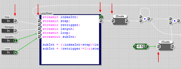

Here's an issue found in the display of single streams, which in some cases are being incorrectly represented on screen by double stream icons (see the red arrows):
Bug - float streams depicted as doubles.png (88.93 KiB) Viewed 27148 times
Re: FlowStone 3.0.9 Beta1
Posted: Sun Dec 20, 2015 5:29 pm
by MyCo
yep, that's already fixed
