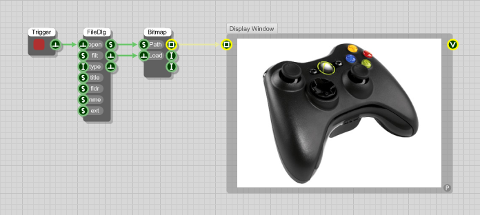

Yes, if you hover the mouse over the component it gives you a description.
Here's an example:
Display Window clip.png (68.68 KiB) Viewed 15908 times
Please note that the component reference is not for modules (i.e components are the base FlowStone building blocks and modules are made using components).
