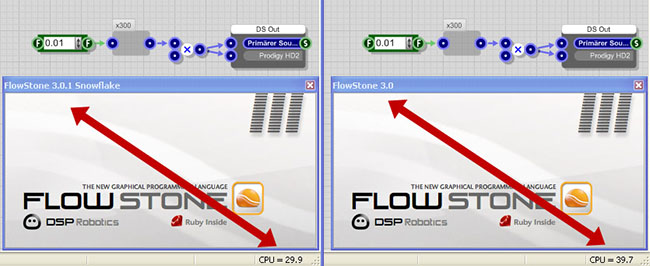

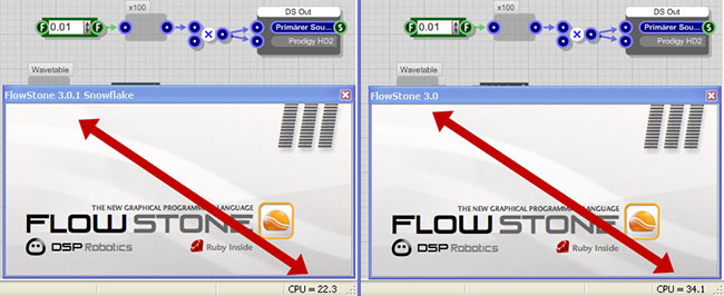

I thought I demonstrate some of the new improvements and features. Let's start with the good news for all previous S|M users. The Devs improved the oscillators, the difference on SSE2 machines like most audio geeks have, is huge. Take a look here:
Saw oscillator
Wave table oscillator
Sine oscillator
Basically, that are ~33% less in most of them.

Just to complete the first post. Here are the benchmark schematics, that I've used for the oscillator CPU measurement.
