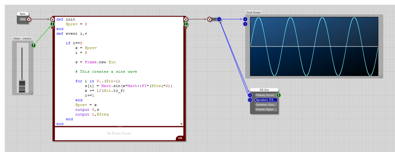

It is possible to do this in Ruby if you use the mono to frames and frames to Mono.
Here's an example of a sine wave generated in Ruby:
Ruby mono to frame sine example clip-2.png (105.27 KiB) Viewed 33822 times

Dear support, the problem is also with performance of such functions.
Computers have limited speed ;-)
Ruby version would not be suitable neither to my research project that involves multiple generators (even with built in sine osc - I can't use all units at once) nor to my research projects that involves special modulated filters (blue approximation of green version - eats about 3x time of CPU, and ruby version would eat much much more I guess).
