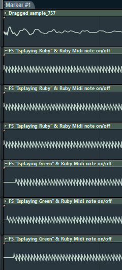

After a few days getting dodgy timing results, i went back to the start.
I first tested the "Is playing" module, to see if i can get at least get the first note on the money.
Using Green it fails everytime
Using Ruby it nails it everytime
(Note: the midi note is generated in Ruby for both tests)

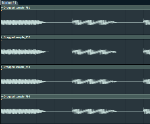

Here's the one note test.
Attached to the stock "Arp" module, it's 100% accurate every time, just like (FL Studio)SM
So for me the Timing issue is finally dead.

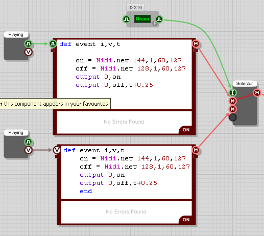

Note in the example I'm using Midi note 60 for the first hit. This is wrong, as it will always
give you the wrong note on the first hit. ie: not the user selection.
The user selection in the ARP Module should be routed into this "midi note 60" position.
Should not be an issue. Its there waiting in green at the "Preset string" module.
Just need to extract it and route it back into the ruby "is playing code".

billv wrote:Its there waiting in green at the "Preset string" module.
Yes, the Ruby prim' behaves a little differently there - it stores the input/output state at save, and re-loads it at startup (like a green sample and hold). So Ruby never creates a "backwards trigger" to request values - you always need a trigger to 'push' the value into the input.
