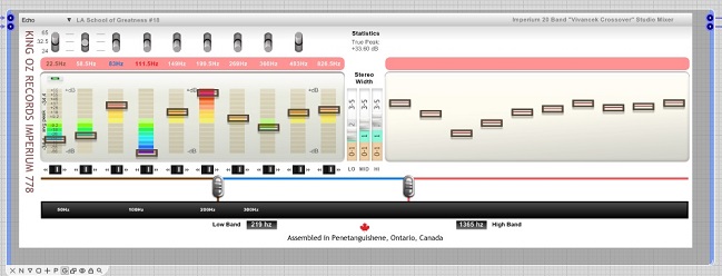

I have been very happy with Your one pole HP and LP filters Martin,
And wondered; If I was to use the same code for a crossover; Is it possible for You combine the code of both the HP and LP
so that it uses less resources?
I have a 20 band one working now and yet it only uses 1.4 cpu. I wanted to ask You if it is possible because it would save CPU.
I wanted to name it Vicanek crossover eq; is that OK?
Basically it is an equalizer for people trying to avoid the math of a co-efficient equalizer. The results are pleasingly jagged and yet
the transients are also tilted. Sometimes I find linear amplitude added is more ideal.
Please let Me know; I think Your LP and HP are the best I've tried.

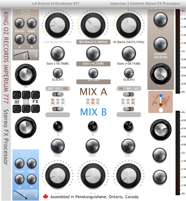

I recently used them in a new product I'm working on called the TQ:
TQ EQ (Thanks to Loopeytunes for Knobs):
The attachment tq resized.jpg is no longer available
Imperium 778 (20 Band Vicanek Crossover) Thanks to Loopeytunes and Nubeat for GUI Elements
Vivancek Crossover EQ
Imperium 777 Processor Thanks to Loopeytunes and Nubeat for GUI Elements:
imperium processor
imperium processor
imperium 777.jpg (122.85 KiB) Viewed 34633 times
