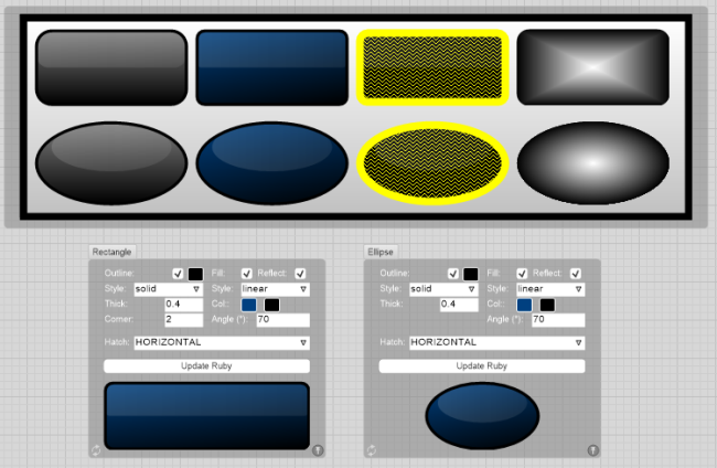

Hello!
Today a was making some GUI in ruby and as a "Lession" i did a port of the old Rectangle & Ellipse Modules from Synthmaker V3 / FlowStone V2
As you see i also did properties for config
What is new is the Hatch-Brush.
If you have any ideas for updates/upgrades please write here ;)
Base-Module - Free4Use in any Project.
For all Ruby nerds - please take a look how i did port all variables from te properties to the main module - maybe there is a better solution - if someone could do that ;)

Hi chackl - nice stuff, bringing some of the new Ruby graphics options to a simple module. :)
Here's my version of the "options hasher". The @vals data is stored using the saveState/loadState methods, so there's no need for the 'input scanner, so there are far fewer events and triggers kicking about...

Re: Rectangle & Ellipse Module in Ruby
Posted: Thu Aug 22, 2013 12:01 pm
by chackl
Thanks for the example i'll update it within the next version :D
And thanks for the little ruby lesson :D - I've just began to understand ruby and i'm now experimenting with custom objects and classes.
Thank you :D
Posted: Thu Oct 31, 2013 5:36 am
by nix
love the hatching brushes mr. Hackl
is it possible somehow to define the size of the hatches?
Posted: Tue Nov 05, 2013 1:20 pm
by chackl
nix wrote:love the hatching brushes mr. Hackl
Thanks ;)
Well i did not find anything - if someone finds a metode i can add it ;)
Posted: Tue Nov 05, 2013 1:22 pm
by chackl
billv wrote:@chackl..... may have a little bug...
if change fill style to 'solid'
.no color changes possible.... no hatching either... ??..
Well a hatch allways needs 2 colors ;)
So Hatch is an addition to solid/Linear/Radial.
