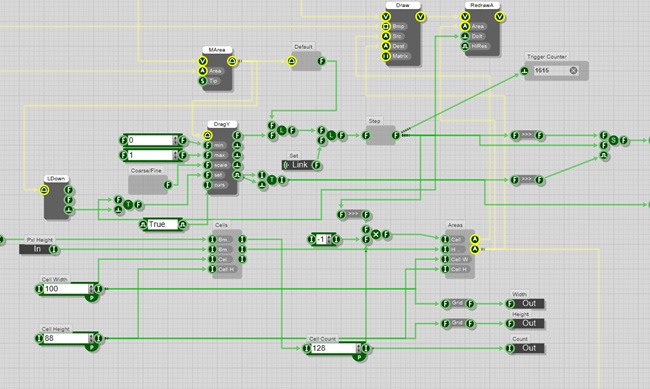

Posted: Thu Jul 16, 2020 12:48 pm
by lalalandsynth
Old thread but thought I would mention something I encountered.
If you have a change prim on the output of the knob then I am successful in reducing the trigger from the knob, so all good there.
But when I try and reduce the frame count by placing the change before the redraw then when I do Ctrl Click to to reset to Default value it will not send a trigger and therefore not reset the actual value, only the knob, visually .
Where would you place the change prim to reduce frame redraw ?
Any thoughts on this ?

Posted: Thu Jul 16, 2020 2:29 pm
by trogluddite
For the frame drawing, look for the point where the value gets rounded to integer (the frame number), then use the 'changed' on this integer (for confirmation - the next calculation is usually a multiplication by the frame width or height, which may or may not convert the value back to float).

Posted: Thu Jul 16, 2020 4:35 pm
by lalalandsynth
Here is my knob so what I would want to do is to limit the redraw triggers right? Where that trigger counter is.
Feels like i need to reduce the triggers somewhere before that right ?
I can put a change in front of that Step module and that works but will not update the value when I use Ctrl Click to reset the knob.
