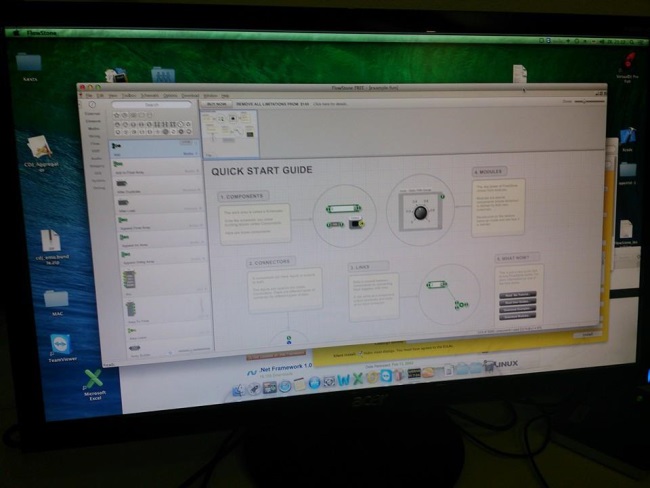

Well this is on of those Topics that might be hated by mac-haters.
Well i'm a 'little' hater too but there are users there outside that are let me say 'only able to work on mac'
So this Pic will get you up - and NO - this is no fake!!!
This is FlowStone Free runing on an OSX 10.8.5 powered with Winebottler:
(App gets arround 700mb :P)
Well - I have to say - it run for eaven 10 seconds before it crashed ^^
