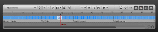

I basically want to use FlowStone as an Animation Timeline (sequencers) much like the FlowBotics "Pattern Sequencer" is used to move servos over time - i.e. on a timeline. I would like to start an MP3 (I can do that) and then based off of the "time-code" output several queues of different ASIO analog output channels (ASIO works fine with the GIGAport)...
See abut 1/3 down page... Under "FlowBotics Studio Demo Projects"
http://www.lynxmotion.com/p-883-flowbot ... v2-cd.aspx
or here
Sequencer
Sequencer
I would buy FlowBotics Studio if I knew I would get the source module(s) so I could customize it...

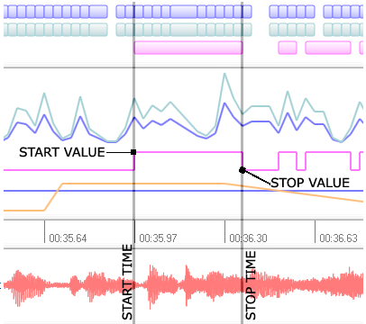

Here is a better idea of what I am trying to do...
So at some point in the "song" a value in the timeline is output to say turn on a light (Boolean on/off), or control its brightness (integer or float, 0 to 100%).
The idea is to have multiple channels say 10 (or 20?) and have an output associated with each channel. The during the playback those values are "input" into FlowStone and subsequently out a hardware item I have attached to the machine (PC).
The output is no issue, USB to DAC's and Relays working well. I just need a way to elegantly input and edit the "on/off queues" to turn lights on and off, etc.
Again the user should be able to move the "queues" back and forth on the timeline to change when the lights turn on or off or a value gets output, etc.
Hope this helps, it is more a timeline editor (think video transition editor) and less like a sequencer, but they are related in some ways...
Thanks again...
Aron
