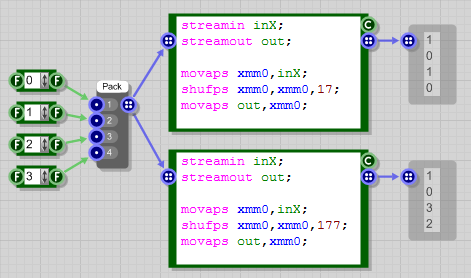

KG_is_back wrote:It treats mono4 as two stereo pairs (0-1 and 2-3)
In that case, should the third parameter of the shufps instruction not be 177 rather than 17?
Re: Stereo Limiter
Posted: Mon Jan 20, 2014 10:09 pm
by KG_is_back
Yes :oops: you are right. A stupid mistake I've made.
