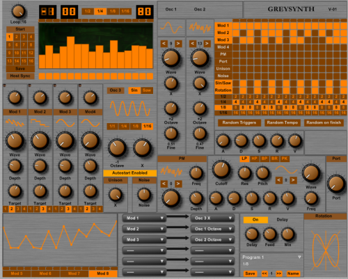

Hey Guys, here's a new toy. Its got a bit of "X11" theme to it.
A basic synth with some mods, routing matrix and automation matrix.
There's 8 presets, so all you have to do is hit the start button. :)
[img]
[/img]
Grey Synth_v01.fsm
(1.48 MiB) Downloaded 1344 times

Thank you Bill for sharing.
It looks very interesting and I'm sure that I will learn plenty by "dissecting" it.

Wow, that's heaps of fun - and great to see the X-series still going strong. In a very good way, it makes me wonder what Tom and Jerry cartoons would be like if they'd been scored by the BBC Radiophonic Workshop. Maybe I'm not the only one around here who grins from ear to ear at vintage Dr. Who soundtracks instead of finding them scary? :? :lol:

That’s excellent Bill!
I can see just how much work went into that and I’m very impressed. :ugeek:
I was wondering why the Preset Manager didn’t have the usual menu system. Do you rely purely on the DAW’s fxp and fxb system?
Also I feel I should mention that the first preset on loading was just into clipping on my system, but it took me ages to find the master volume control. Maybe it could be separate and bigger…?
This is amazing work and thanks so much for sharing it with us all.
