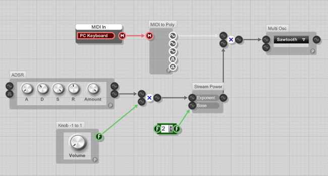

If your trying for +/- 1 octave multiply your signal by your knob set your knob to -1 to 1 connect to power and use base 2 that way your knob at -1 multiplies by 0.5 = 1 octave down and at 1 multiplies by 2 = 1 octave up.

by Xtinct
Easier to show than describe
ENV Pitch.png (76.91 KiB) Viewed 21647 times

Ah nice mate but what do the stream power module do? AH like fixing the pitch?

the exponent function is a power I think,
so because frequencies rise exponentially,
the envelope value will too.
so before the exponent, the value looks like this as it rises->
1,2,3,4,5...
and after
1,2,4,8,16...

Its just a way of centralising the knob, you could just replace with a knob that go's from 0.5 to 2 but the no change ie multiply by 1 would not be in the center and if you wanted more octaves the effect would be more pronounced.
Try it and see use the power and set your knob to -2 to 2 = 2 octaves up / down then use a knob without the power that go's from0.25 to 4.
