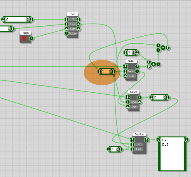

I'm working on a solution for this. I'm almost done. There's just one little thing that prevents posting it...
The following works very well. But, at every start of the loop, the marked integer box needs to be set to -1. That also works very well, as long as I do it manually. But everything I tried to automatically set that box to -1 right before starting the loop just failed. I know that it fails because of the triggers. But if I work with trigger blockers, sample & hold, etc., the results are wrong (mainly because the needed triggers now also don't come through anymore). I can't believe that something so simple, as setting the int to -1 only works manually!
So does anyone have a solution? Or a tip? Anything? :cry:

Use green selector, connect -1 to true input and what you have there to false. Then setup comparator to be true on first loop and false on others (I can't see from where to where you're counting) and connect it to the selector.

Thank you KG. Unfortunately, as soon as it switches to the false input the select prim sends out triggers. That leads to a second calculation of the already calculated value (the first time the marked int will be 5, the second time it should be 8, in this example). So instead of using 5 (which leads to 8), it recalculates 5, which results to 11 (at least the calculation is correct :lol: ).

Place somewhere sample and hold prim(s) and retrigger them only once to avoid feedbacks. This will pass values only once. Triggers in this design seem to be "bonded" so to speak (i.e. not separated by timers for example), so they should follow trigger order. In this case the S&H trigger will go from the point (the loop prim?) where the thing starts shooting (remember about trigger order).

The int box is inside a green connection loop (its output is indirectly connected to its input). There is no simple way to fix that, because every trigger that changes the box goes through the "add" primitive and changes the int box again. It needs some S&H primitives and some "Last changed". Unfortunately you posted just an image and not a schematic...

MyCo wrote:The int box is inside a green connection loop (its output is indirectly connected to its input).
Yes, that's on purpose. The equivalent of "n += somefunction(n) + x". At least that's what I try to achieve :lol:

This has it, I think...
intboxissue FIX.fsm
(2.08 KiB) Downloaded 1107 times
As MyCo says - always post a schematic. Fixing a problem like this is not easy without knowing the semantics - exactly WHAT you are trying to achieve. In this case, knowing the purpose has allowed some other optimisations, as well as the fix for the initial problem. The whole thing immediately made sense once the clever 'arrays within an array' structure could be seen (very nifty!).
- The FIX. A 'Last changed switch' that sets the start value - note the trigger order, it is set before the loop begins. A trigger blocker inside the feedback loop prevents runaway triggers - the output from the 'Get' is enough to update the new index.
- The second "get at" is now only triggered when the loop is done, not every single iteration.
- The 'sample and hold' at the end ensure that the final output only triggers once per operation.
Note that there is something odd about the 'Array Section' primitive. Usually a trigger at any primitive input causes all other inputs to update their value - this would suggest the optimisation of trigger blocking the 'start' input. But this particular primitive doesn't seem to do this, so there's no way to update both the start point and the count without it updating its output twice - hence the final sample and hold to ensure "one in - one out" triggering for the module as a whole.

Thanks a ton, trog! I was trying to get this working for 3 days now!
trogluddite wrote: - The FIX. A 'Last changed switch' that sets the start value - note the trigger order, it is set before the loop begins. A trigger blocker inside the feedback loop prevents runaway triggers - the output from the 'Get' is enough to update the new index.
So easy, if you look at it now. I wonder why I couldn't think so logically? Thank you so much.

Was playing with it... My version uses the previous value instead of another "Get Array"
