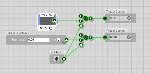

Had a bit of a laugh-out-loud moment with this. I can hear my clock ticking in my kitchen from here, so I just rigged this up and clicked start on the tick, then without looking counted 60 ticks, then clicked off, and this was the result. :lol:

Perfect Human Interface wrote:Ok, answering my own question here (sorry for being so scatterbrained guys, really).
:o :lol:
Now that will make DSPr proud! It's exactly what they promised in the user guide. The schematic timer used for ruby (green uses windows timer) runs at 100 Hz, is much more stable and locks to asio if present.
