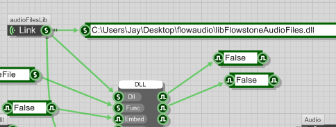

ive tried your project m8 cheers for sharing that! :) but i could not get it to work, the dll component does not seem to load or see the dll file and it returns a false result for "Whether the dll was found" and "Whether the function was found in the dll",
no worky.png (15.65 KiB) Viewed 36849 times
I just have the dll file and the project in a folder on my desktop! im on win7 x64
I thought it was my firewall or something along those lines stopping it from working but nothing with all of my security stuff off either!
any ideas? would this be dependent on any runtimes or that?
great project though :)
Re: Flowstone Audio Files project
Posted: Fri Nov 07, 2014 1:19 am
by MyCo
The DLL is compiled non-static so it depends on 2 other DLLs (LIBSTDC++-6.DLL and LIBGCC_S_DW2-1.DLL). You can avoid that by adding the compiler switches -static -static-libgcc to the linker step.

MyCo wrote:The DLL is compiled non-static so it depends on 2 other DLLs (LIBSTDC++-6.DLL and LIBGCC_S_DW2-1.DLL). You can avoid that by adding the compiler switches -static -static-libgcc to the linker step.
I've build a wave reader for a wave player just one month ago. Although waves have a pretty easy format, there are so many types that you can work forever on this.

Jay wrote:Hi exo
I have updated the DLL with the static linker options, so hopefully this should work for you now :)
