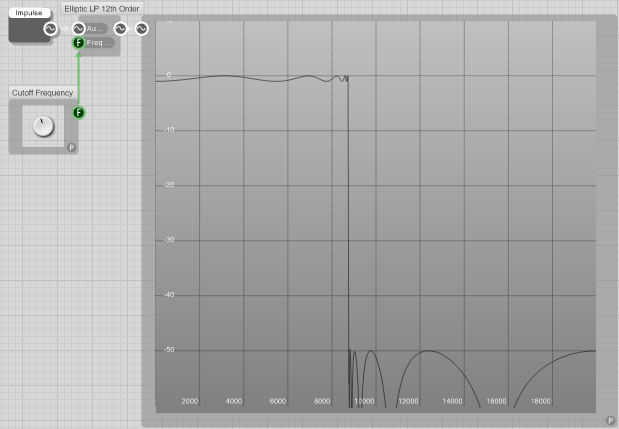

Here is a tunable 12th order elliptic lowpass as an example:

You can copy and paste the coefficients from the cnx site into the textboxes in my schematic. The other tools have a different output format, you have to unscramble the coefficients before pasting.
I am attaching a highpass filter example.
