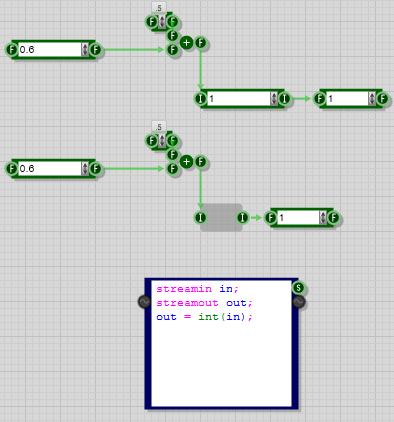

Here is stream and green->
integers.fsm
(606 Bytes) Downloaded 932 times

nix wrote:Here is stream and green->
integers.fsm
Yes. But I meant: what if you have a Float prim with value 2.234523 and you want to "round" to 2 digit (i.e. 2.23)?
Such as round in Ruby.
Re: Approximate numbers Help
Posted: Thu Mar 24, 2016 10:55 am
by nix
edit- Nowhk mate, this wasn't a reply to you, just showing it if it doesn't open in current FS.
I'm sure I know how to format, just a sec
Posted: Thu Mar 24, 2016 11:02 am
by nix
format.fsm
(381 Bytes) Downloaded 1006 times
Formatting command was found by Trogluddite,
hope helps, but maybe not what you want

nix wrote:
format.fsm
Not sure how fast is passing between float-string-float. Anyway, that's won't "round" really to the last digit, just "cut" the string.
