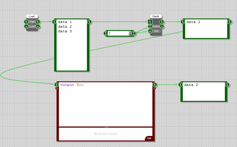

Depending on the nature of the data and how you want to process this data.
To read any kind of textual data, you can use load text file primitive. Then, you get data at the index you need using array get at.
Data Collecting.PNG (36.67 KiB) Viewed 36113 times
Obiviously to find a correct data of any index, you should know how the other program works. And this will be easier if the program uses fixed indexing.
Another solution is to "find" a string inside the text file... Etc.
There are many solutions, and ruby can do more (but im a synthmaker user so ruby is to be explored for me).
If the file data.h is compiled, and non readable this makes a lot of problems. Maybe running Ruby you can decompile it, but will not be so easy as i said before.
If is readable, just create your custom data parser.

If the lines of this text files does not change ever (the line number) you can use this example and continue with it:
Custom Parser.fsm
(3.33 KiB) Downloaded 1343 times
To read line, just change the int value of the parser (string get at) loader.
