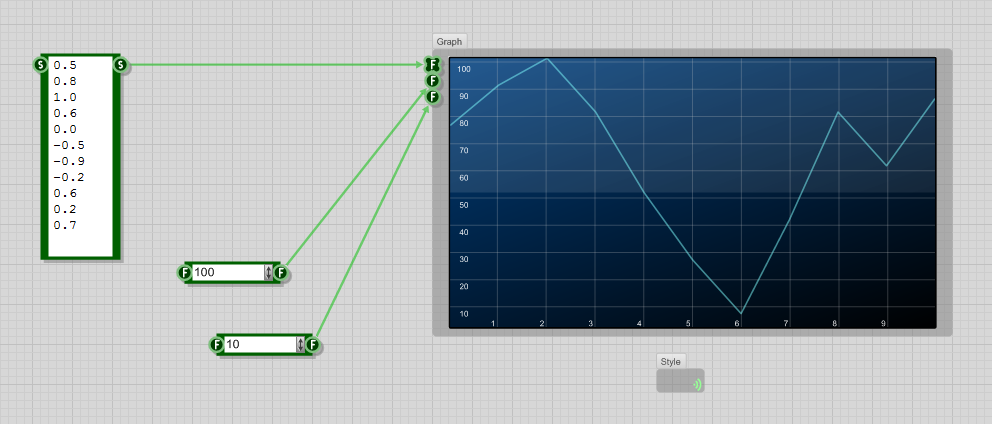

There is a Graph Module in FlowStone that takes an array of floats and draws a graph. If you look at the FFT Module you will see how it is done.
eg.

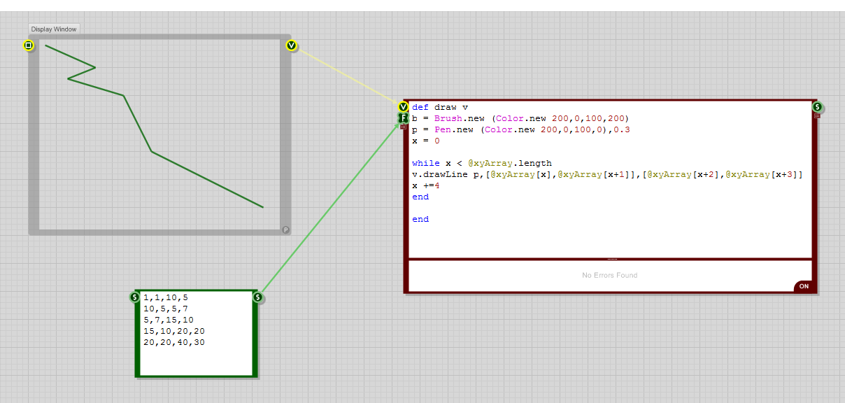

Yes correct but now we have Ruby there is a better way:
