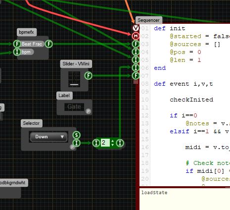

hi, thank you very much for this scheme, there is just something very important that I have not managed to get working,
It is the modality of the ascending, descending, combined and random sequence,
I think something is missing in the code, how to fix it?
modality
modality
2021-02-17 00_47_28-FlowStone 64Bit-Sequencer.jpg (42.43 KiB) Viewed 33584 times

If they can write in Ruby the solution I elaborated,
to enable sequence modes
I would appreciate it very much.
