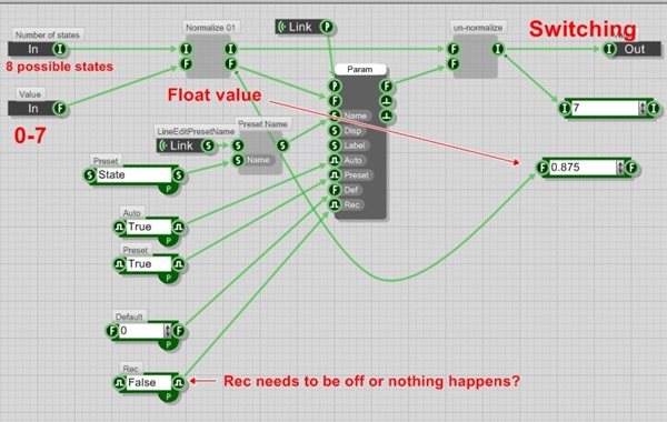

It seems to me like Automation Recording has to be turned off for host automation to work.
I also nomalized the values for the preset prim (I think preset values must be between 0 and 1).

Yeah sorry that was the wrong file, changed it now

Thanks ! This works :)
I wonder why it cannot be automated from the GUI itself -Rec ?
And why enabling rec -disables the automation ?

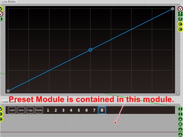

Problem number 1,
I am switching between 8 envelope shapes , using integers from 0-7.
This needed to be "normalized" or converted to float between 0-1.
rec 2.jpg (39.2 KiB) Viewed 33286 times
Om's solution was to "normalize" the values to get float value to represent 0-7
This however requires the Rec to be disabled or it does not work to automate it.
Other then that this worked for the example posted which is just the basic advanced envelope , except that it has been changed to 8 possible shapes rather then 4.

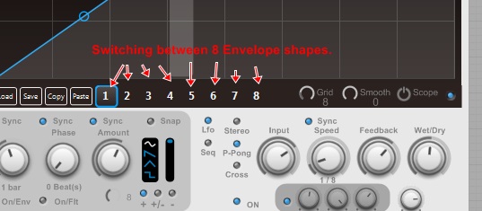

I will make a simpler example but If you want to check either my initial example posted*which did not work for obvious reasons) or Om's solution then the preset module for the switching is in here.
rec 3.jpg (63.65 KiB) Viewed 33286 times
