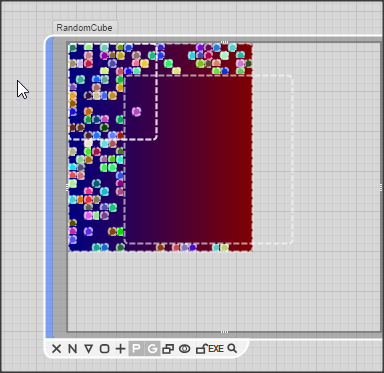

I am not sure if understand you right, but empty mgui layer with redraw on top will do this:
Snap 2021-11-21 at 18.03.32.png (39.69 KiB) Viewed 42311 times

I think you have to understand that you are using some cheat or trick in FS, and what you see is actually not there. You must do some 1 per sec. tick or one pre 10 sec. tick to make the rectangles still there, you have only two modules - that means only two rectangles fill the area 25x times per sec. at around 1% of whole area. So I suggest 100 would fill it all the time you set on ticker.
According to: reading unconsciousness and so... Actually some visuals can "close" the perception of it - changing the times, layers, and dimesions or random algo. helps subject to stay focused on. Its boring to watch only squares that changes colours so my interest slip away from that.
I just changed the dimensions and times and multiplies the rectangles. It dont fill the area anyway 100%
