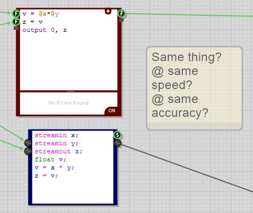

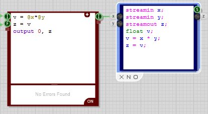

BUT is this the case with the ruby input/output? If ruby is processing at sample rate like a stream is, at the same level(buffer) as a stream, is the output to be trusted? Like if I process an INT array in ruby at sample rate, and output an INT... is that INT accurate, or is even that in/output hole subject to green inaccuracy? Can I run out of that ruby INT output directly into a stream?
(picture below)
If I do, is it at sample rate speed accuracy? essentially creating an uninterrupted stream from inside the ruby module processes, out of the INT out, directly into a STREAM in on a DSPCODE box, and out the other side? Is that whole chain sample accurate? or is that one step of green ruining it?

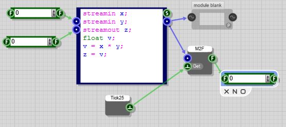

ruby directly to stream>>
111 4.JPG (24.17 KiB) Viewed 10667 times

All pictures above are generalizations, not specific examples.

First of all, to avoid misconceptions, there is a difference between "sync'd to sample rate" and "running at sample rate". Ruby is sync'd to sample rate, as soon as ASIO is present, or it is used as a plugin in a DAW. It is NOT running at sample rate. It keeps running at 100 Hz.
Since a buffer can be quite large, you can get Ruby to perform something while this buffer is treated by the DAW or Soundchip, but that needs time. I doubt you can do anything meaningful with Ruby, while running a 3ms buffer.
So, where does sync'd to sample rate make sense then. When it comes to preciseness. When it doesn't matter, if something is calculated through one or more buffers, but that an event happens exactly on time with a specific sample. Method scheduling and timed events are two examples. You could basically prepare a whole pattern of notes to be scheduled, when the user hits the "arp on" switch, for example.
Anything that leaves Ruby via an output type other than RubyValue or Frame, is subject to that type's timing. Green is event-driven, so basically it would react instantanously, but only, if it isn't busy with other things. Those other things are defined by their appearance in the schematic, the order of links, the placing of multiple links from one output to several inputs, etc.
Ruby reacts to input changes immediately. The maximum delay would theoretically be 9.x ms, but in practise this will rarely be the case. However, it is for a reason, that DSPR always said, that Ruby's internal clock is reliable down to 10 ms. If you go lower, it will of course be unreliable, it is running at 100 Hz.
