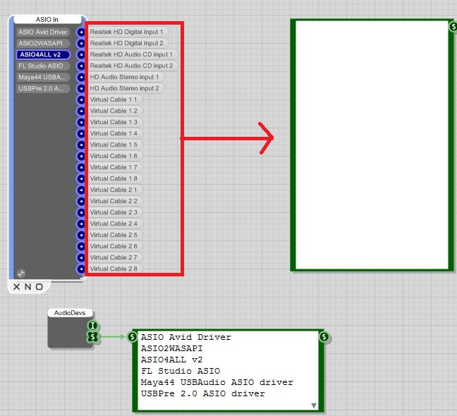

hello, i'm korean Flowstone user.
how can i get list of asio available input or output name to string array?
i found component returns list of audio device(asio name) but i don't know how to get list of asio inputs/outputs name.

Hi,
right now it's not possible to get the list of audio I/O.
I think we could add a primitive that could output that. I'll add it on our todo list and come back when it's done

Re: get list of asio i/o name
OK, that was a quick add. It'll be available in the next release
