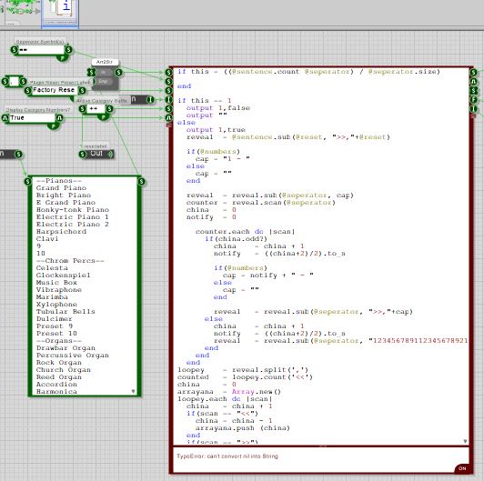

Hi Guys, I bring a matter related to Ruby, it is a preset manager that works but after a moment of work, Ruby presents a nil error in the code, which means that something is missing,
I found this scheme somewhere a long time ago, I don't remember correctly, but I assumed that copying the code and taking it to the ruby component of my version 3.0.6 of FS would solve it
I added an afther load to it, but even so, the nil error appears.

Its because your ruby inputs dont have any names

hi adamszabo, the names of the inputs are added, and still, the error nil appears,
so I restarted the component, closed and opened it, and apparently the null error is gone.
but after opening the project and making some adjustments to the connections of other modules, the null error appears again,
So I think something is happening in the code, and I even think it may be a bug from version 3.0.6 of FS,
Now, I received help from Kortezzzz with the corrected schema conections for version 3.0.6 and I just have to experiment and see that the nil error does not appear again,
I was also suggested to switch to FS 4 alpha as a lot of bugs have been fixed, including the bug in this ruby-based preset scheme,
So, soon I will share my news about this scheme,
Anyway, if they manage to solve it with a different method or any modification in the code, I will be attentive to receive it
