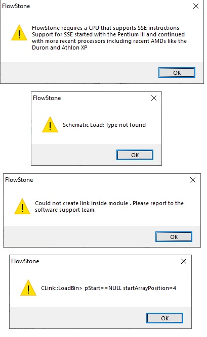

Thank you for your response! This is very helpful, and I do hope to improve and learn! I am having trouble opening some flowstone projects. When opening, I get an error that says "Flowstone requires a CPU that supports SSE instructions." This only happens with some flowstone projects.

Warkauze wrote:... I am having trouble opening some flowstone projects. When opening, I get an error that says "Flowstone requires a CPU that supports SSE instructions." This only happens with some flowstone projects.
Wow, this is the very first time I’ve heard of this!
I’m far from being an expert on CPUs and stuff but I thought all modern CPUs support SSE and SSE 2 instruction sets and have for a long time. The export dialogue has the option to support SSE and I always leave it ticked because it’s essential for just about everything to work. I’m puzzled! What CPU are you using?
Hopefully someone else can ask more relevant questions and offer advice...

Might it be that Warkauze is trying to open files made in a Flowstone 3.09beta?
Warkauze can you point to any .fsm project file here at the forum that produce error?
You can also check if other software is able to recognize support for SSE by your particular CPU.
For example, here is CPUID: https://www.cpuid.com/downloads/cpu-z/cpu-z_2.03-en.exe
It will show support beside "instructions" when you run this utility.
Are you able to open these projects that produce errors at all? or does Flowstone crash?

This is likely what Warkauze encountered:
It also get it when I try to open some .fsm files. Atleast in the FS version i'm currently using (FS3.081).
The same files usually seem to work fine in FS4 so likely they are FS4 (3.09beta) files. But they might not be. I don't know.
Here is an example (symmetryknob) of a shared .fsm that will envoke SSE dialog etc and crash my FS3.081...
http://www.dsprobotics.com/support/viewtopic.php?t=53302
- R&R
- Posts: 474
Re: How far can the inbuilt modules take me, and how do I us
I tried that and I don’t get the actual SSE message, just a warning that it’s made with a newer version of FS, but it’s probably because I use 3.06 and have done for some years now.
But I agree that’s what he’s seeing. I’ve added a moderator comment to the post for the knob.
